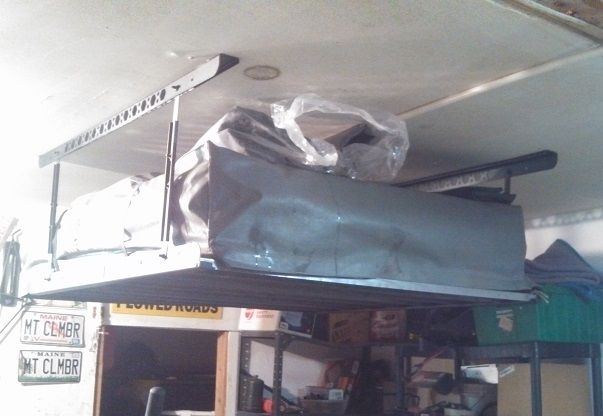

I also purchased an overhead storage rack thingy from Lowe's so I can store the RTT inside the garage for the winter too. It's not assembled yet, but I'll be sure to post pix when it's hanging off the ceiling...

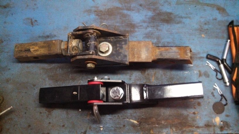

Why did you decide to go to the other brand hitch?

I'm very picky when it comes to rattles, clunks, shimmies, etc. This homemade hitch is bombproof and has been put thru the extreme tests. However it does have a few "loose" spots that can be improved upon, and I'm just too lazy to continue with fixing it to be honest. I'm sure it's a simple fix too, but the new owner can figure that out.

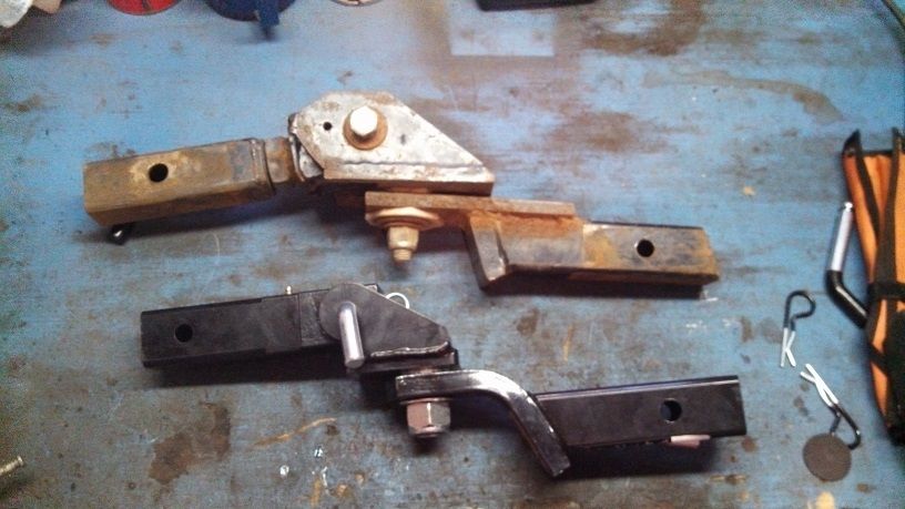

Max Coupler arrived a few days ago. Had to buy a new vehicle hitch end to achieved the proper height behind the Taco (all my other ones either already were in use or the wrong height). This nice little powder coated unit is smaller and lighter by 4 lbs (17 vs. 13).
It has a greasable pivot on the trailer end and rebuildable bushings if ever need be.
AllanR- Posts : 525
Points : 464
- Post n°85
Re: MtnClimber's Adventure Trailer
Well you can tell the "side to side rotation" on the hitch end is different. But How is that different? Like how did they build it compared to how we can see the other one is done.
Also looks like it might of shortened up the over all length by about 3"s?
And I see they used a pin instead of a bolt for the "up down" part of the hitch.
The "bolt" doesn't have a nut, only a hole drilled in the other end for the hair pin to go into. Tomato, tomatoe

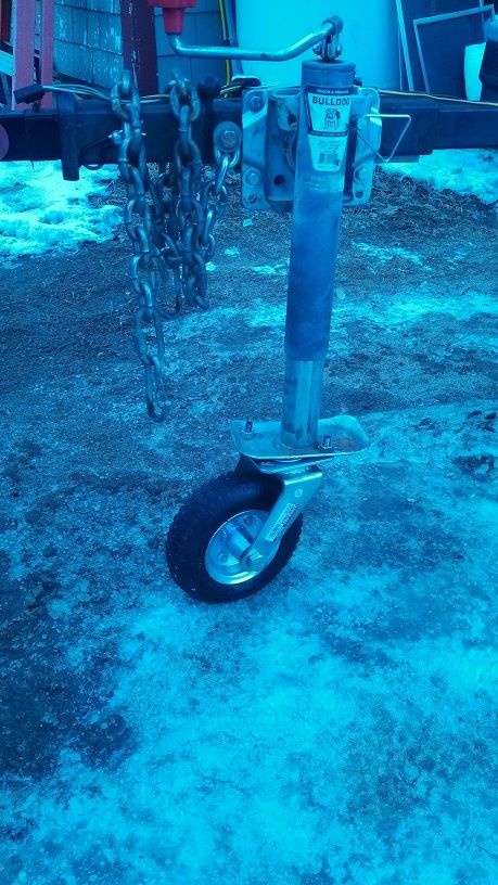

This'll make it easier to move around. And now the jack reaches the ground too, that was always an issue. Previously, I had to use the Hi-Lift base to get the trailer off the tow vehicle and get the trailer level.
That's a nice pneumatic wheel that swivels 360*. Can be aired down for those offroad needs.....
