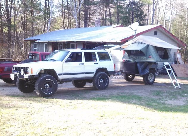

    Trailer Measurements:
    Interior: 44" x 71.25"
    Exterior: 71" wide (outer fender edges) x 119" long (tongue to tailgate, 9' 11")
    Tongue & skeletal: 2 x 2" box tubing
    Upper Rim: 1 x 2" box tubing
    Uprights: 1.5" x 1.5" box tubing
    Tailgate: 1 x 2" box tubing
    Fenders: 3/6" aluminum (wicked rugged)
    Floor: 5/8" plywood
    2000 pound TSC axle, 58" wide (hub surface-to-surface)
    New wheel bearings
    1750# springs
    1.5" wheel spacers
    5 x 4.5" wheel bolt pattern
    33 x 12.50 x 15 Pro Comp All Terrains on 15x7 steel Jeep rims
    NEW LED tail lights & wiring
    Max Coupler
    2K swivel tongue jack with 6" pneumatic tire
    Heavy Duty safety chains
    Some extra's include:
    Front tray with ammo storage can
    Hi-Lift mounting provision
    Yakima load bars for an RTT
    Jerry can mount
    Ample interior eye bolts for tie downs
    Wheel chocks, tire changing provisions, ratchet straps, spare wheel bearings
    NMW Tested & Approved
    VOT1 Successfully Accomplished
    Can't wait to try it this weekend!
    And of course I added some swag  Cool

    Post by AllanR on Mon Apr 29, 2013 7:09 pm
    how did you like using it this weekend ?

    Post by MtnClimber on Tue Apr 30, 2013 7:20 am
    Allan, it worked perdy good. I wasn't able to fill the trailer with all my camping stuff, haha. I plan on adding multiple tie down area's w/in the trailer. The tent sets up super easy, plenty of room inside and it holds the heat fairly well for such cool nights (both around 33-36 degrees). It's nice being able to keep my sleeping bag, fleece blanket, and pillow inside the tent while folded up.
    I picked up 3 stock XJ steelies from a fire buddy and also found three 33x9.5 TrailMark's for the trailer too. Rims got painted black to match the current rims on Jinxy. I also shortened up the wiring harness and changed the tongue jack to a pad bottom vs a cute lil wheel.

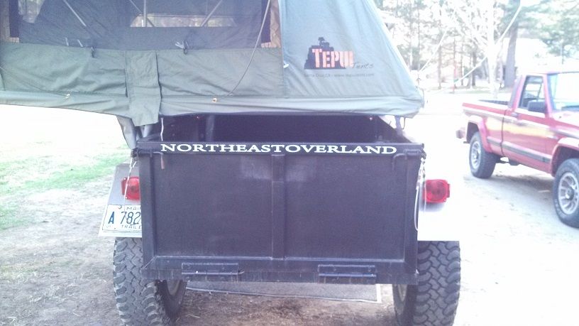

    Post by MtnClimber on Tue Apr 30, 2013 8:19 pm
    More swag Cool
