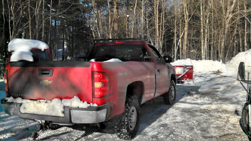

    A good friend of mine has 235/85R75 E Duratrac's on his truck. This blizzard was easy peasy for him...even when the road went right and he went straight out into a field at 3:30 in the mernin. He just plowed his way right out of it.
    Tire rating IMG_20130210_141347_563_zps8926f61e
    He runs a 8.5' Boss Vee plow and tows his racecar with his 09 Chevy 2500. He loves his Duratrac's.
